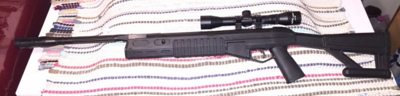

I recently had the opportunity to buy a Crosman TR77 NP .177.
Since I already own a metallic-spring TR77 .177.
Rather, the Stealth version, I thought it would be a very-good direct comparison - metallic spring vs gas ram.

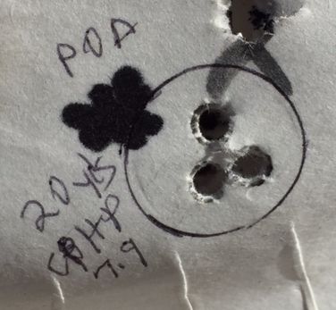

Standing Position, Off-Arm Supported on Window Sill
Off-Hand Lightly Braced Against Window Frame
3-Shots, 20-Yds
CPHP 7.9 grs
However, the first group I shot ... after a little warm-up ... proved to be promising.

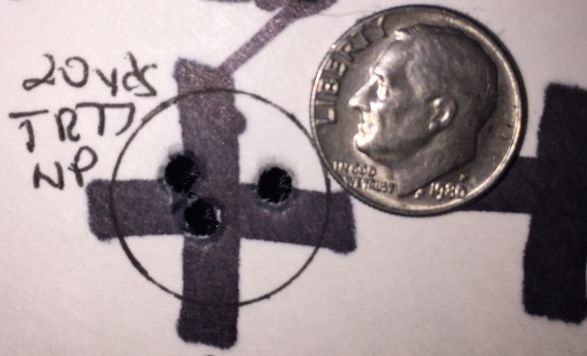

In frustration, I resorted to resting the TR NP on a padded surface.
As such, the TR NP was fully-rested on a soft-surface while my only contact was at the pistol-grip.
This holding technique resulted in a sub-dime, 5-shot group.
Standing Position, Only Trigger Hand Making Contact
Rifle Fully-Rested on Padded-Surface
5-Shots, 20-Yds
CPHP 7.9 grs
Right then and there, I knew my TR NP could shoot.

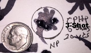

Standing Position, Off-Arm Lightly-Supported on Shooting Stand
Off-Hand Lightly Braced Against Shooting Stand
Light Hold on Forearm and Pistol-Grip
3-Shots, 20-Yds
CPHP 7.9 grs
But, the TR NP is not an easy rifle to shoot ... it demands much effort from the shooter to achieve serviceable results.

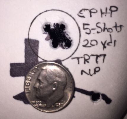

Standing Position, Only Off-Hand and Trigger-Hand Making Contact
Lower-Body of Shooter Braced Against Solid-Stand
Rifle Fully-Supported by Off-Hand and Trigger-Hand
Off-Hand and Trigger-Hand Totally Unsupported or Braced.
5-Shots, 20-Yds
CPHP 7.9 grs
