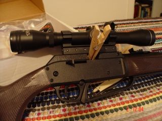

Protecting Magnetic Probe While Using a Cleaning Rod ... Clothes Pin Block

However, I did learn how to protect the magnetic probe from a being struck by a cleaning rod tip.
I now insert a clothes line pin into the breech.
The clothes line pin serves as as block preventing the cleaning rod tip from contacting the bolt probe.
I do the same thing with my Crosman M4-177/M417 and Crosman MK-177 when I'm running patches through them.
