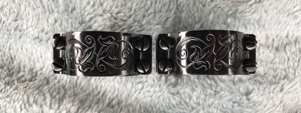

The good news is that the rings that come with the GF are very heavy duty and all steel.
The bad news is they do not fit. They will not tighten down on the 11mm dovetail. I took a set of my "go to" BKL 257, and they fit just fine. Its clear that the CZ supplied rings will not tighten down enough to "grip" the rail! After comparing the BKL and CZ rings side by side (actually upside down, side by side) you can see that the CZ supplied rings are just too wide to tighten down adequately. :(
I will contact CZ on Monday to see how to remedy the issue.

CZ 455 Grand Finale
Well, let me state the facts so Im not confusing myself or anyone else.
The rings have ZKM 452 marked on them. To the best of my recollection and after taking a quick look at the CZ website, all 452's/455's use the 11mm dovetail.
I have always used the BKL 257 rings for all of my CZ Rimfire scope installs.
These do look very much like the rings that came with my 527 Royal Centerfire rifle, but I do not have it handy to make a comparison.
They actually slide on without an issue, but they will not tighten down anywhere near as much as they need to. And when comparing to the BKL's, they are clearly too wide even after tightening as much as is allowed.
p.s. After looking more carefully at the CZ website, I see the American takes 3/8" rings...so this makes it even more interesting. I will call CZ on Monday and speak to them and get some clarity.
http://www.rimfirecentral.com/forums/wood/attach/jpg.gif
It looks like to me that the rings are for a 11mm dovetail and the Grand Finale is 3/8 inch as it should be. That is why they will not tighten down enough. I see no part number on my package. BKL will go either way.
Here it is with my favorite scope, Nikon Prostaff EFR.
It is currently using the BKL 257 until I can get the CZ engraved ring mishap corrected. She's a lil beauty. :bthumb:

Discussion starter · #37 ·
CZ 455 GF ring issue
I just got off the phone with Jacob (38 minutes) at CZ USA and the resolution is mixed. The GF they have in house and the rings supplied work fine (so he was told). So the issue is either the dovetail or the rings. (uhhmmmm ok)
They are out of stock of the 3/8" ring and have back ordered a set for me. Once they are in, I should be able to swap out the bases and all will be well. I was told alternatively they might have to order some to be made (with engraving and 3/8" base) from CZ if this turns out to be a larger scale issue. That would obviously take some time.
It seems to me the easy solution is to send out new bases if the swap works as they say it will. Regardless, when they send me a new set of rings I will swap out the bases and see if this resolves the issue.
I was also told that this might be a case by case issue. My recommendation is to call Jacob and report if you have similar issues.
As soon as I get the rings, I will let you know. Its stunning that they don't have a set in stock!

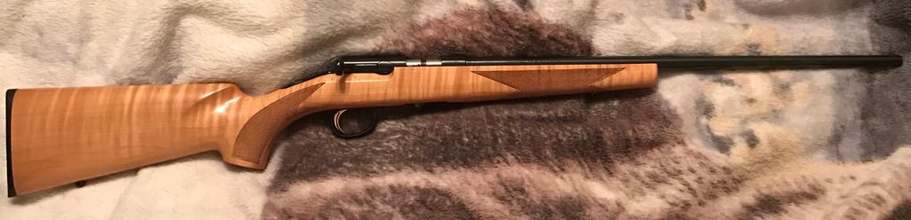

Discussion starter · #40 · (Edited)
This one for a 452 CZ is one of the best I own. It doesn't compare to the AAA fancy Browning or AA Cooper I have, but for a CZ its super. I know at $1k+ it could have a more traditional Fancy grade wood, but the checkering, grain and depth are excellent.
This (Below) is what most folks call "great wood", but it isn't always about maple/stripes. The checkering and depth of the grain of the walnut on the (GF) is excellent. There is unique layering varying levels of grain throughout.
