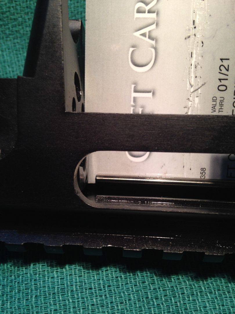

Below are a series of pics describing what I mean on a Kidd charging assy in a TM receiver.
First, cut off the card as described above.
Next, install the charging assembly in the receiver. Pull the charging handle all the way back. The act of grabbing and pulling the charging handle back without the bolt in the receiver places an eccentric load on the charging handle, causing it to lever and scrape along the charging rod. I've found it best to start with the barreled action upside down on the bench. First, I pull the charging handle back about 1/2", then place the tip of my RIGHT index finger on the leading edge of the charging handle at its center inside the receiver, and push it all the way back. At this point, I hook my LEFT index finger onto the charging handle outside the ejection port, with my thumb hooked around the back of the receiver. I'm able to hold the charging assembly with the spring fully compressed with my left hand only.
It would be at THIS POINT that the credit card is installed.
Then I install the bolt, rear first and pushing the front down onto the charging assembly.
Then, while hold gentle downward pressure on the front of the bolt, slowly release the charging handle. It will click into it's slot in the bolt, then maintain pressure to ensure that the bolt drops in above the ledge that defines the inferior margin of the ejection port.
The only difference using the card is that you will need to hold downward pressure on the bolt while working the card free from between the bolt and receiver.
Rocking the card front to back works best. As I said, in some applications there is little to no room for the card trick to work, and a Gunsmither Bolt Bar is best used.
Personally, I only use this trick to teach my kids, and they both use it to assemble thier 10-22s because their hands are too small and lack the strength needed to assemble the action without help.
The rest of the pics are self explanatory.
