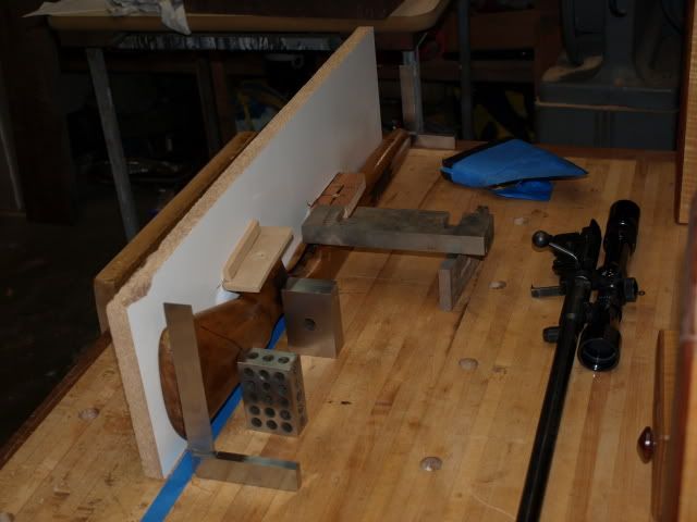

The tricky part was figuring out how to accurately cut the two pieces of the wedge to fit together. I came up with the idea of using a baseboard to support the stock and also be a cutting guide. Here I am aligning the stock so it is flat and straight to the board.
During the set-up I glued and clamped support blocks to the base plate that would support the stock.

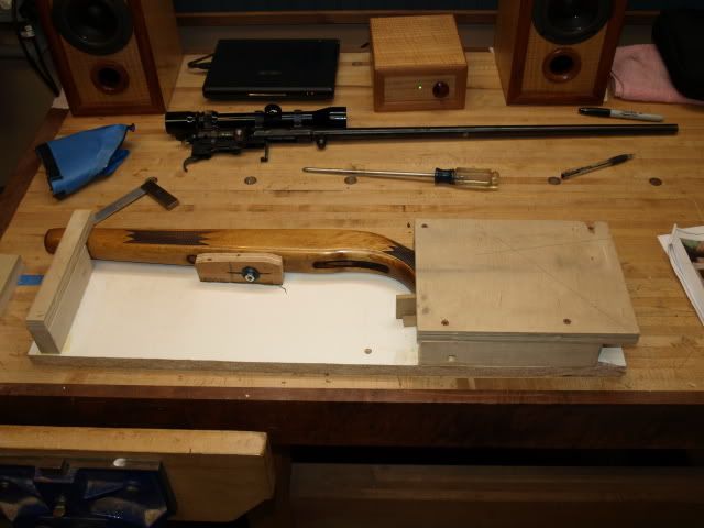

The real key was adding the top cut-plate and front guide to help in precision cutting on the bandsaw.
I cut right through the top plate, base and stock in one pass. This then gave me a perfect template for the walnut wedge.

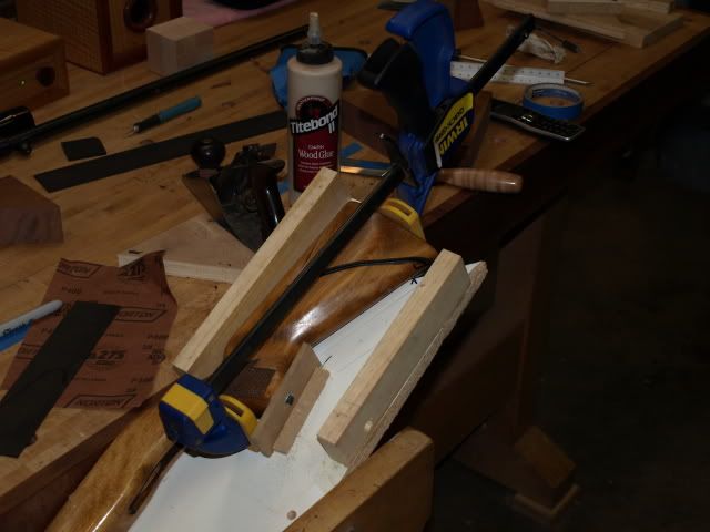

I sliced some 1/8" thick strips of ebony on a table saw, gave them a quick clean-up with the hand plane and carefully trimmed them to the correct intersecting angle. I used the original stock as a caul to glue the strips into place. (it is hard to see but the maple chisel in the picture is what i make for a living)

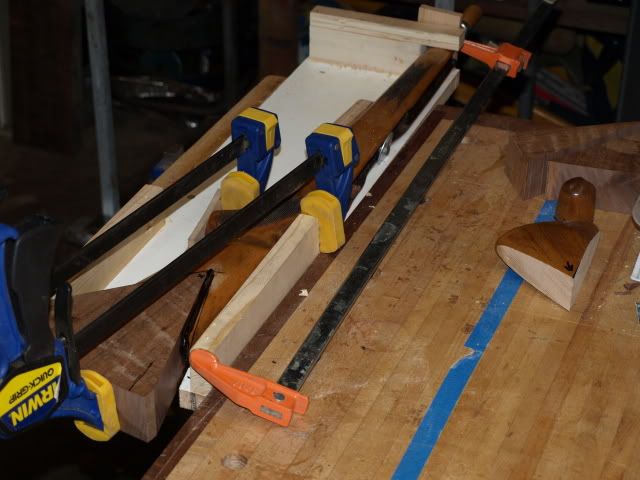

The baseboard became a really easy way to clamp the walnut blocks into place
